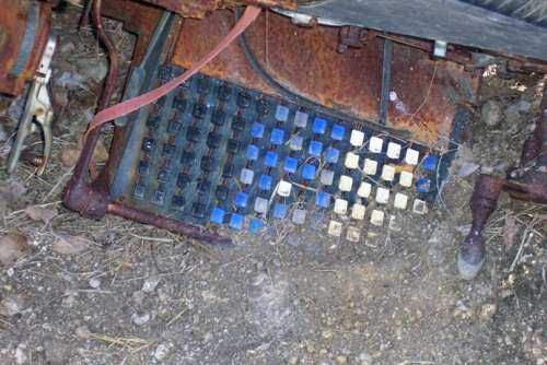

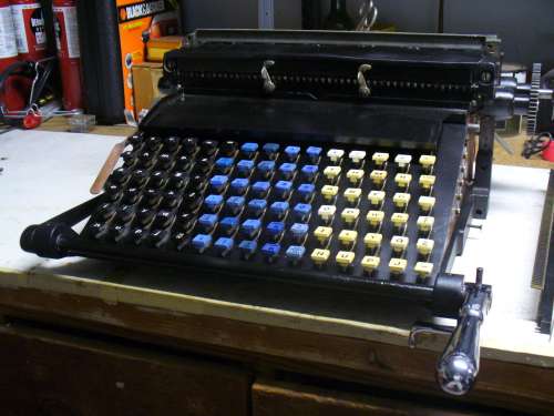

Dan Williams, who posts on here frequently, came up twice this summer, once in June, and again just a few weeks ago. On his first trip up, he brought the fully restored keyboard. Together, he and I installed it and the keyrods and, with a motor hooked to the machine, managed to produce the first motor-driven movement of the keyboard in twenty-two years. During his second trip in late August, Dan worked hard to get the motor driving the cams. By the time he left, the cams were running around once every seven seconds.
